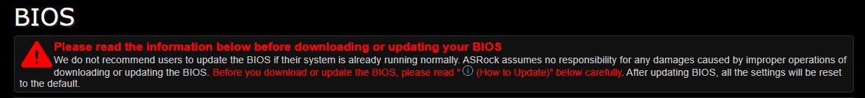

After updating BIOS, all the settings will be reset to the default.
