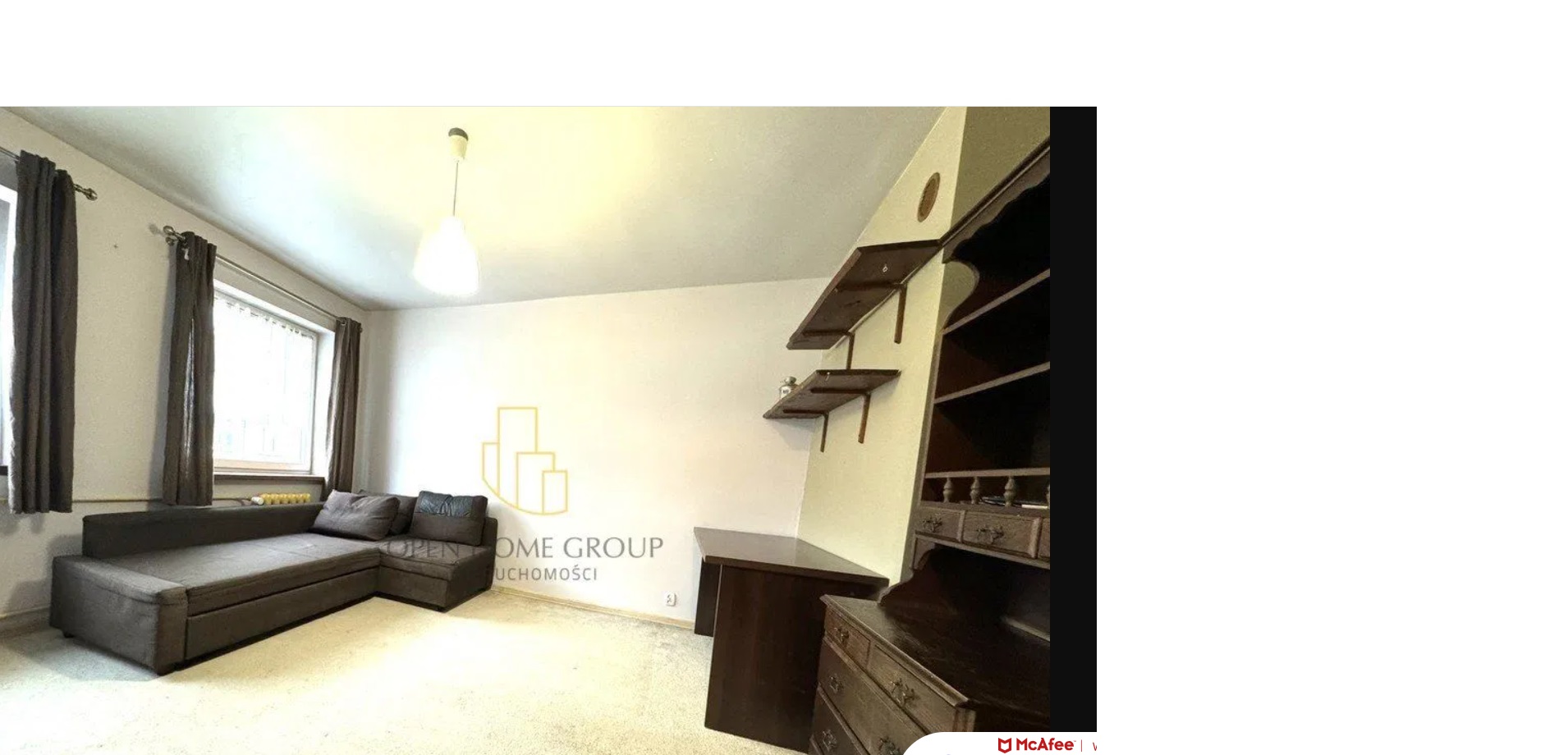

room:

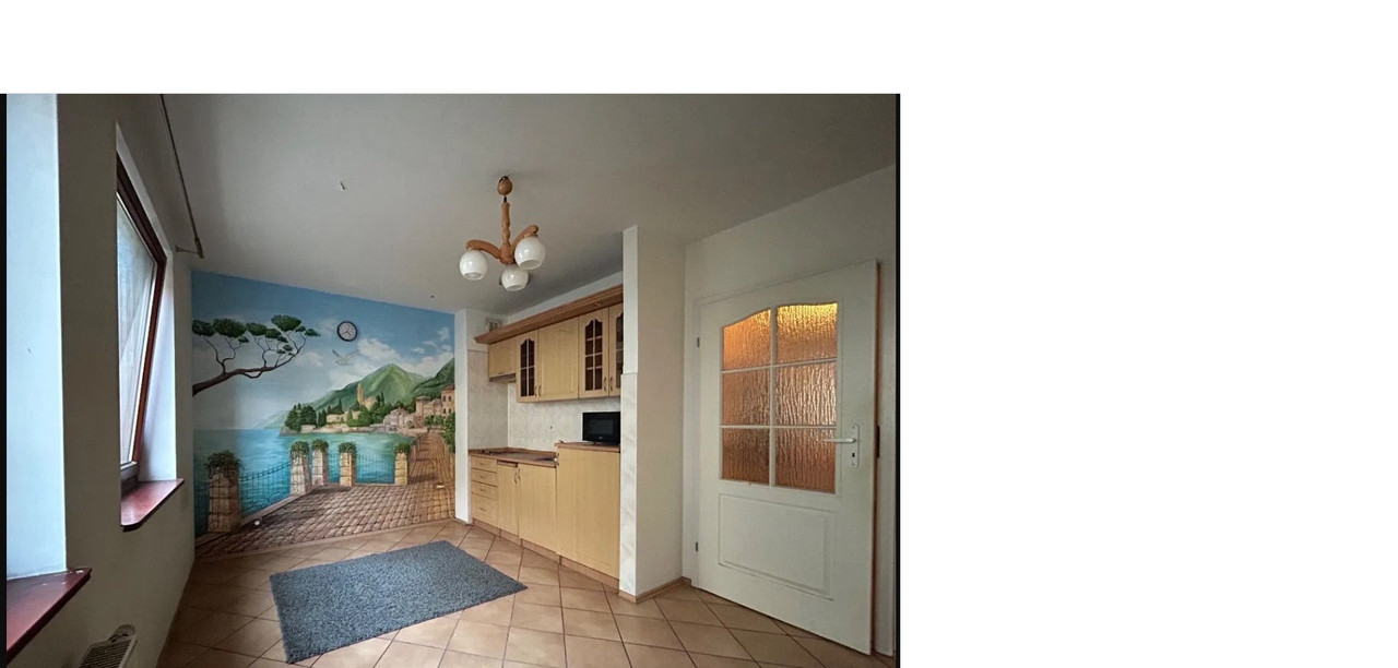

This is screen with room with next apartment but with new electrics( with gas heating too ). Like you see there is also kitchen. Where should i place pc to be safe? Look:
Near window but what if will be raining?
Someone said this to me:"I would never place a PC in a kitchen - any PC that's as fast as the one you mentioned WILL be pulling in a lot of air, and that WILL result in steam being pulled into your case and making your heatsink and fans sticky, likely eventually causing the heat death of the system."
So skip that apartment if there is kitchen in the same room? But i think is well ventilated.
Ok so what is better choice that apartment with room with older fuse box ( but kitchen on separately room ) or that last apartment with kitchen on the same room? :)
