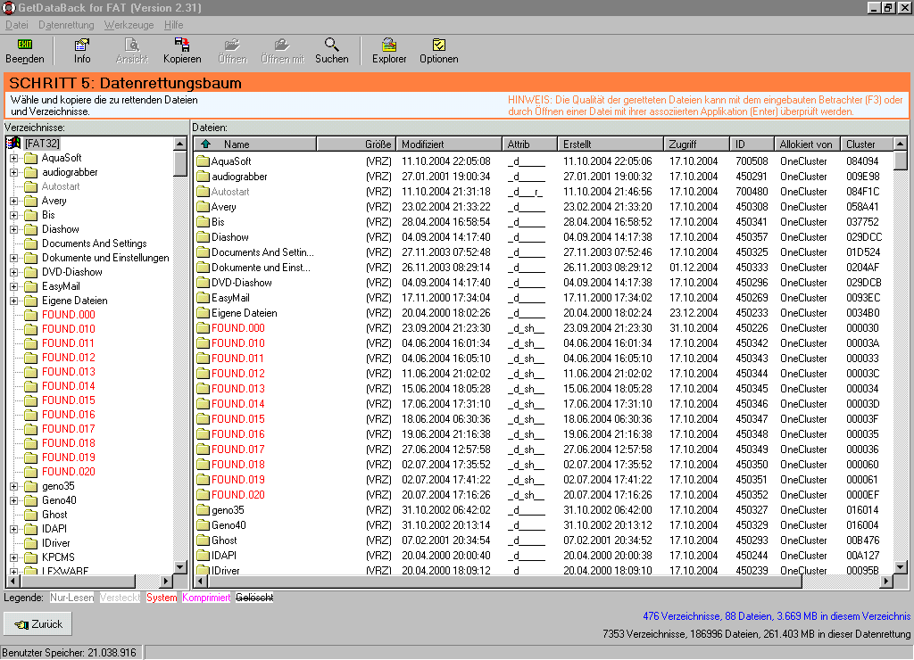

Habe mit "getdataback for FAT" wieder einen schönen Verzeichnis-Baum um Daten rauszukopieren..aber eben nur weil die Daten ja sektor für sektor gelesen werden bei solchen Programmen.

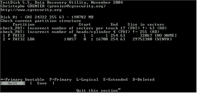

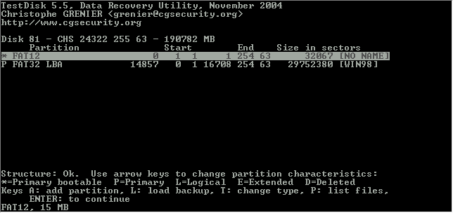

TestDisk 5.5, Data Recovery Utility, November 2004
Christophe GRENIER <grenier@cgsecurity.org>
http://www.cgsecurity.org
Disk 81 - CHS 24322 255 63 - 190782 MB
Partition Start End Size in sectors
* FAT12 0 1 1 1 254 63 32067 [NO NAME]
P FAT32 LBA 14857 0 1 16708 254 63 29752380 [WIN98]
Structure: Ok. Use arrow keys to change partition characteristics:
*=Primary bootable P=Primary L=Logical E=Extended D=Deleted
Keys A: add partition, L: load backup, T: change type, P: list files,
ENTER: to continue
FAT12, 15 MB

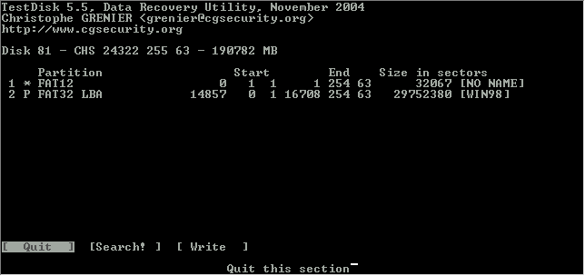

Disk 80 - CHS 2490 255 63 - 19536 MB
[Analyse ] [ Delete ] [MBR Code] [Geometry] [Options ] [Advanced]
[ Quit ]
ENTER: to continue
FAT12, 15 MB
1 * FAT32 LBA 0 1 1 1 254 63 32067 [NO NAME]
2 P FAT32 LBA 14857 0 1 16708 254 63 29752380 [WIN98]
[ Quit ] [ Boot ]
