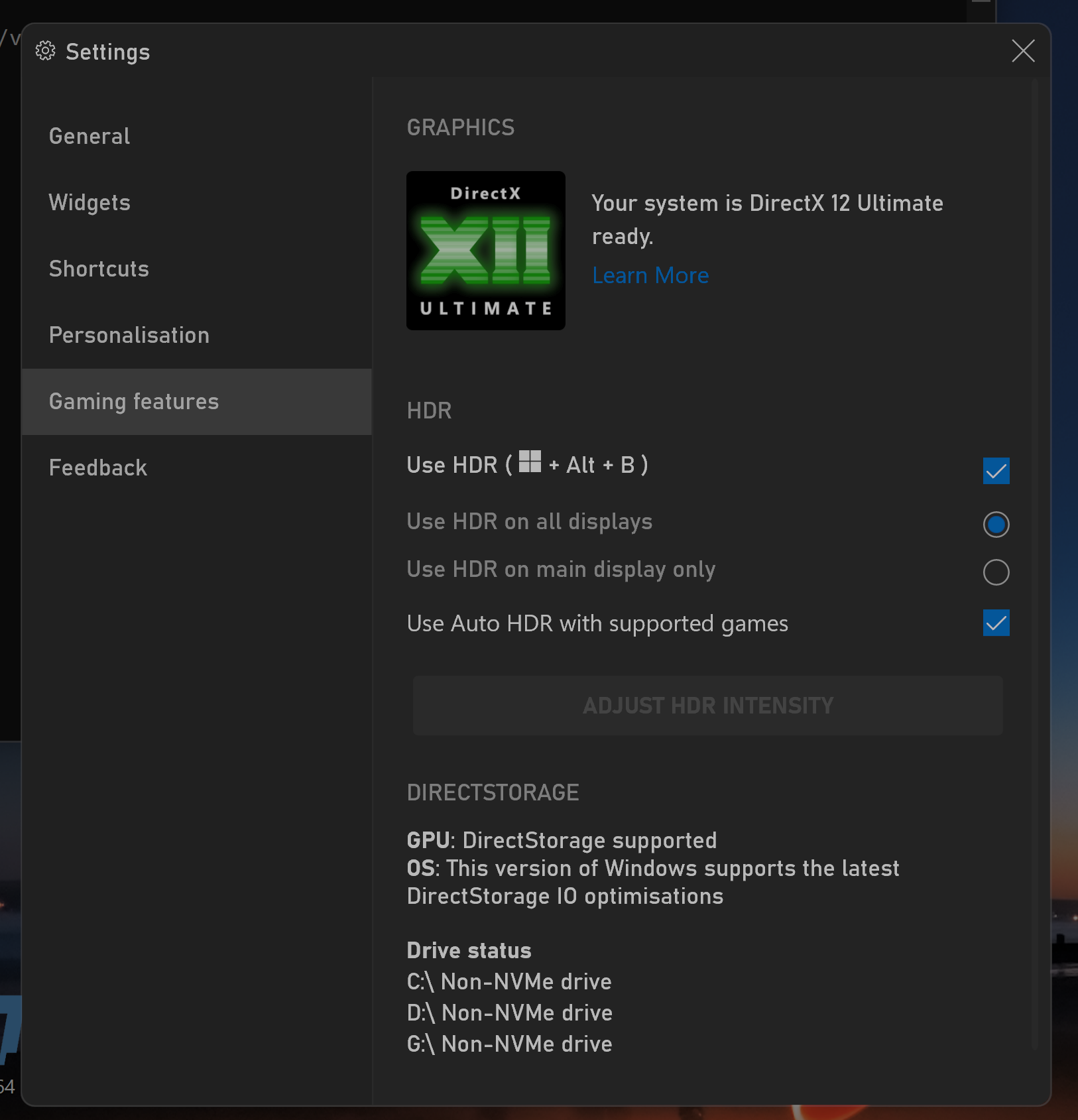

HisN thanks for the reply. There is a bit of a problem with testing. I asked the question before the purchase decision: 1xCrucialT705 2TB (if DirectStorage does not work with RAID 0 on AMD platform) or 2xCrucial T705 2TB (if DirectStorage works on RAIDI 0 AMD platform) right after their release. I find information that RAID 0 users fail to "turn on" DirectStorage because Xbox Game Bar then does not detect the NVMe drive.
I wonder if games can still use DirectStorage despite such a message, or if RAID 0 definitely blocks this possibility. I could be wrong, but perhaps Avokado-Demo circumvents these limitations, and DirectStorage may still not be available in games.
Therefore, I am looking for the opinion of a practitioner on an AMD platform who has already had the opportunity to test DirectStorage technology in RAID 0 in games. I care about the highest performance in games (FPS/load time).
have already bought: 7800X3D + ASUS ROG STRIX X670E-F + G.Skill Trident Z5 NEO (DDR5-6000, CL30-36-36-96) in anticipation of the release of the Crucial T705 2TB, trying to build a gaming PC without compromise. In this situation, I also care about DirectStorage. Ahead of me is the purchase of 4080 Super, but in this case I have no dilemmas.
Der Gamebar sagt zu meinen SSDs die in einem Datenträgerübergreifenden Volumen stecken auch: Is nicht.
Forspoken und die Avokado Demo hat das nicht gestört.
