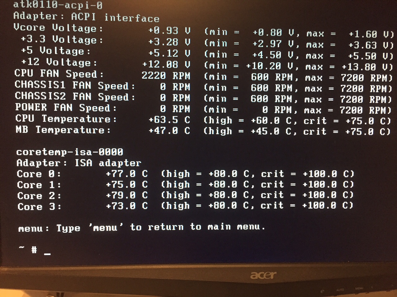

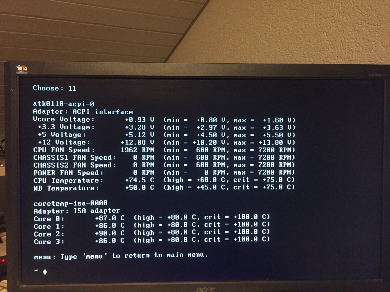

Im live Linux ca. 2 - 3 min später da ich ja immer das LM sensor installieren muss so aus:
Code:
sAdapter: PCI adapter
temp1:        +60.5°C  (crit = +120.0°C, hyst = +90.0°C)
atk0110-acpi-0
Adapter: ACPI interface
Vcore Voltage:       +0.93 V  (min =  +0.80 V, max =  +1.60 V)
 +3.3 Voltage:       +3.28 V  (min =  +2.97 V, max =  +3.63 V)
 +5 Voltage:         +5.12 V  (min =  +4.50 V, max =  +5.50 V)
 +12 Voltage:       +12.08 V  (min = +10.20 V, max = +13.80 V)
CPU FAN Speed:      2057 RPM  (min =  600 RPM, max = 7200 RPM)
CHASSIS1 FAN Speed:    0 RPM  (min =  600 RPM, max = 7200 RPM)
CHASSIS2 FAN Speed:    0 RPM  (min =  600 RPM, max = 7200 RPM)
POWER FAN Speed:       0 RPM  (min =    0 RPM, max = 7200 RPM)
CPU Temperature:     +47.0°C  (high = +60.0°C, crit = +75.0°C)
MB Temperature:      +45.0°C  (high = +45.0°C, crit = +75.0°C)
coretemp-isa-0000
Adapter: ISA adapter
Core 0:       +56.0°C  (high = +80.0°C, crit = +100.0°C)  ALARM (CRIT)
Core 1:       +54.0°C  (high = +80.0°C, crit = +100.0°C)  ALARM (CRIT)
Core 2:       +59.0°C  (high = +80.0°C, crit = +100.0°C)  ALARM (CRIT)
Core 3:       +53.0°C  (high = +80.0°C, crit = +100.0°C)  ALARM (CRIT)
atk0110-acpi-0
CPU FAN Speed:      2008 RPM  (min =  600 RPM, max = 7200 RPM)
CPU Temperature:     +47.5°C  (high = +60.0°C, crit = +75.0°C)
coretemp-isa-0000
Core 0:       +53.0°C  (high = +80.0°C, crit = +100.0°C)  ALARM (CRIT)
Core 1:       +51.0°C  (high = +80.0°C, crit = +100.0°C)  ALARM (CRIT)
Core 2:       +55.0°C  (high = +80.0°C, crit = +100.0°C)  ALARM (CRIT)
Core 3:       +51.0°C  (high = +80.0°C, crit = +100.0°C)  ALARM (CRIT)
atk0110-acpi-0
CPU Temperature:     +48.0°C  (high = +60.0°C, crit = +75.0°C)
coretemp-isa-0000
Core 0:       +54.0°C  (high = +80.0°C, crit = +100.0°C)  ALARM (CRIT)

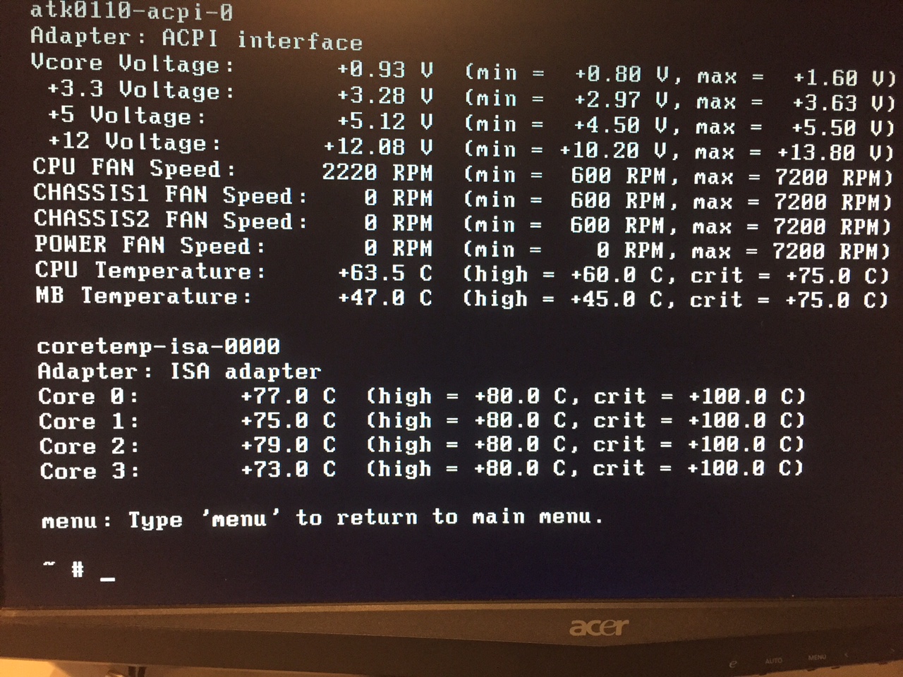

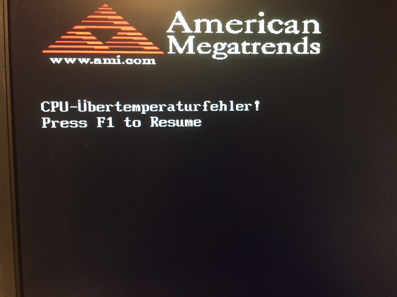

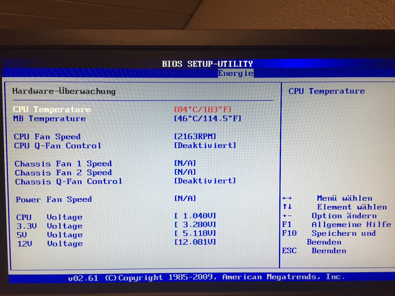

Hier erfolgte einen Reboot und ich aktivierte die Temp Warnung im BIOS wieder und siehe da dieses Bild erscheint:
Bios Tempwarnung bei diesen werten>
Code:
atk0110-acpi-0
CPU FAN Speed:      2163 RPM  (min =  600 RPM, max = 7200 RPM)
CPU Temperature:     +49.5°C  (high = +60.0°C, crit = +75.0°C)
MB Temperature:      +46.0°C  (high = +45.0°C, crit = +75.0°C)
coretemp-isa-0000
Core 0:       +59.0°C  (high = +80.0°C, crit = +100.0°C)  ALARM (CRIT)
Core 1:       +57.0°C  (high = +80.0°C, crit = +100.0°C)  ALARM (CRIT)
Core 2:       +62.0°C  (high = +80.0°C, crit = +100.0°C)  ALARM (CRIT)
Core 3:       +58.0°C  (high = +80.0°C, crit = +100.0°C)  ALARM (CRIT)

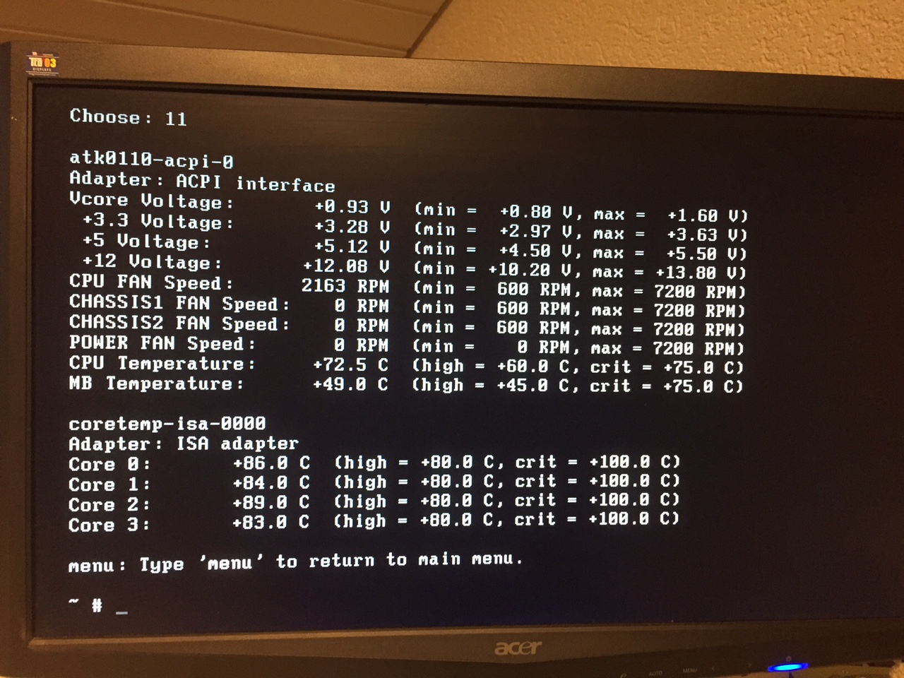

Nach einem Reboot kam die Meldung wieder nun ging ich nochmals in's BIOS:
Der Kühler war jedoch nicht einmal Lauwarm!

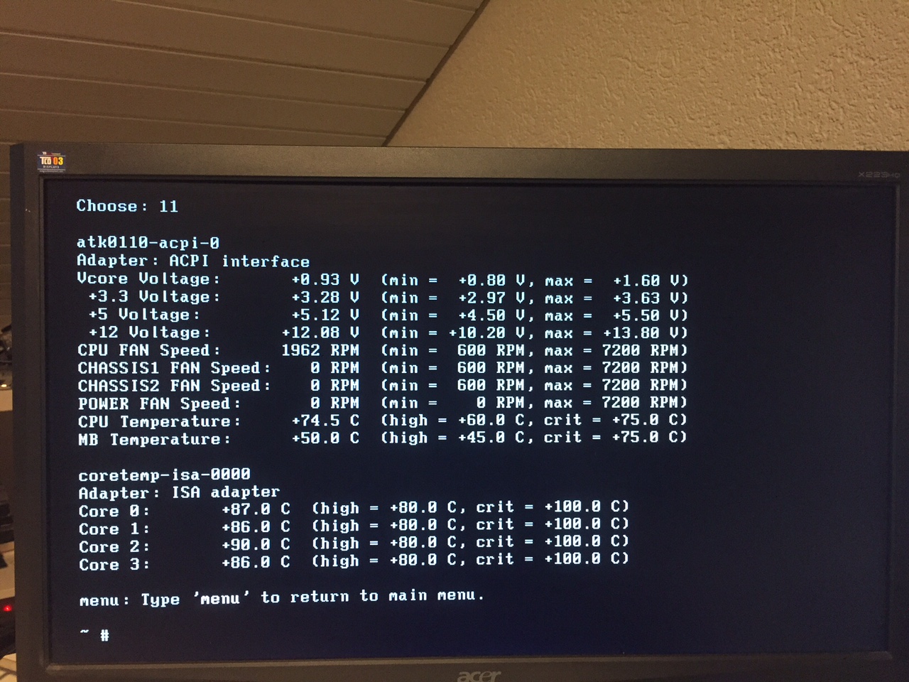

Ich machte noch ein Part tests ( Test mit der UBCD und dem Tool System Stability Tester V 1.5.1) und schaute immer wieder auf die Temp:
jedoch ausgeschaltet hat sich der PC bis jetzt nicht mehr!
Jedoch ist da immer noch etwas im argen!
