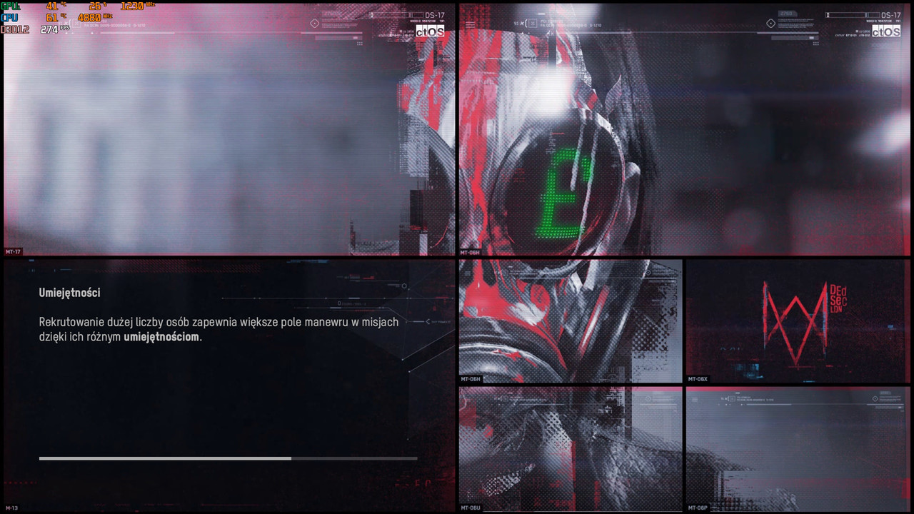

Today i plugged Rtx 4090 Palit Gamerock. It passed 3dmark tests. But after i downloaded Watch Dogs Legion it freezed on loading screen and crashed.

Happened once i testing now Watch Dogs Legion no crashing again since. But why it crashed? On 3090 Ti i dont had a single crash,nothing.
