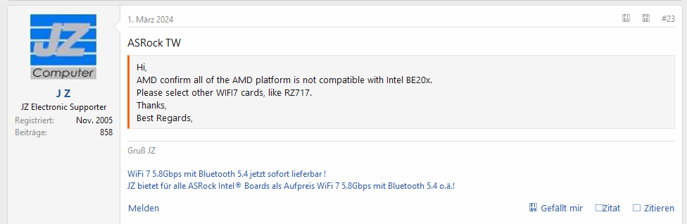

https://www.computerbase.de/forum/threads/intel-wifi-7-be200.2183515/page-2#post-29183386
This is where Intel needs to step in and inform its users if they are working on a solution- or if its BE200/ BE202 works only with Intel-based PCs with Windows 11 24H2.
So, if you're on an AMD-based system and looking to upgrade to Wi-Fi 7, it is best to stick with Qualcomm Wi-Fi 7 QCNCM865 or MediaTek Wi-Fi 7 MT7927/ RZ738 Wi-Fi 7 adapters.
https://www.tomshardware.com/networ...rs-but-they-may-still-not-work-on-amd-systems
