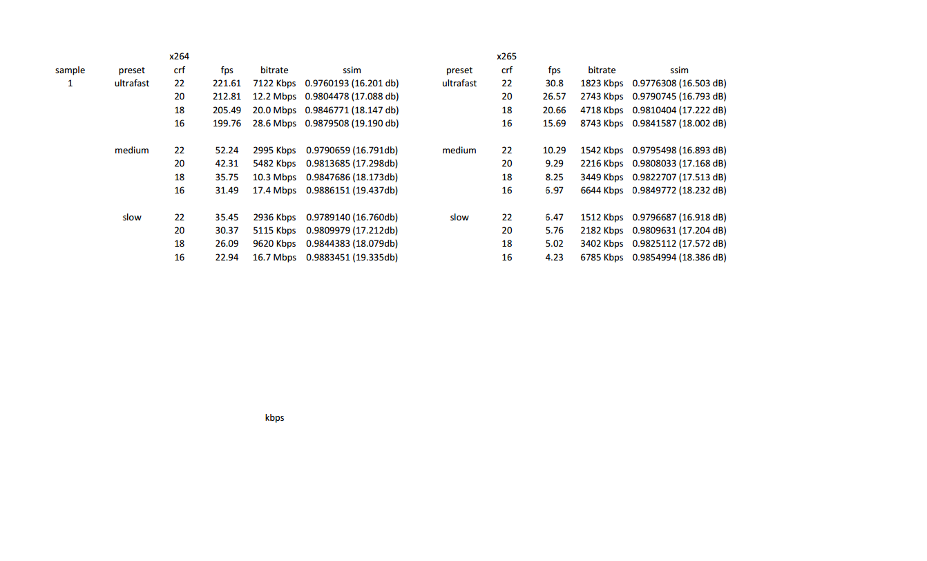

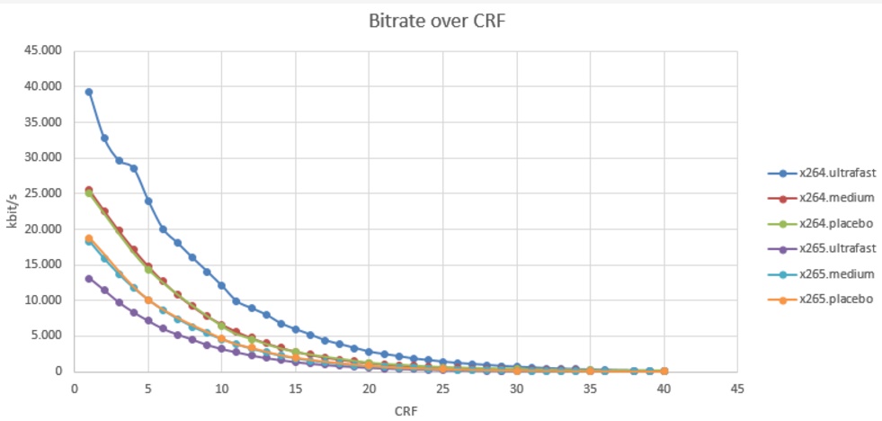

Here's the explanation for what the OP is observing, the slower presets make use of various psycho-visual enhancements that faster presets do not and as you get to the slower settings the psycho-visual settings get more aggressive as well. If you read up on x265's psycho-visual algorithms, and x264's for that matter, you find that various settings will actually pump up the bit rate in CRF mode in order to avoid artifacts.
