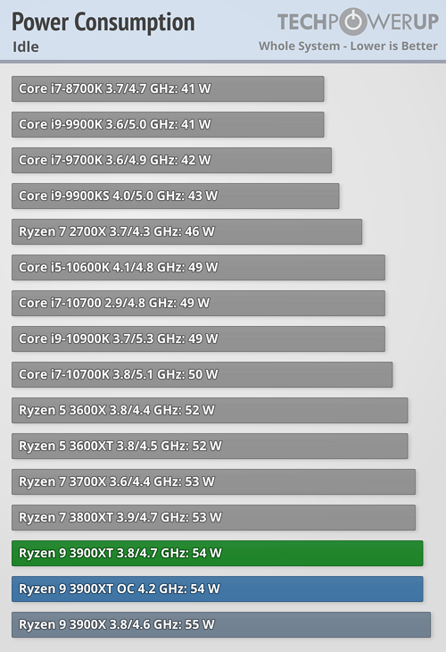

Test System "Zen 2"
Processor:
All AMD Ryzen 3000​
Motherboard:
ASRock X570 Taichi
AMD X570, BIOS v2.80 AGESA 1.0.0.4B​
Memory:
2x 8 GB G.SKILL Flare X DDR4
DDR4-3200 14-14-14-34​
Graphics:
EVGA GeForce RTX 2080 Ti FTW3 Ultra​
Storage:
1 TB SSD​
Cooling:
Noctua NH-U14S
Zadak Spark 240 mm AIO​
Power Supply:
Seasonic SS-860XP​
Software:
Windows 10 Professional 64-bit
Version 1903 (May 2019 Update)​
Drivers:
NVIDIA GeForce 430.63 WHQL
AMD Chipset 1.07.29.0115 (recommended by AMD for Windows 1903, instead of 2.x)​
