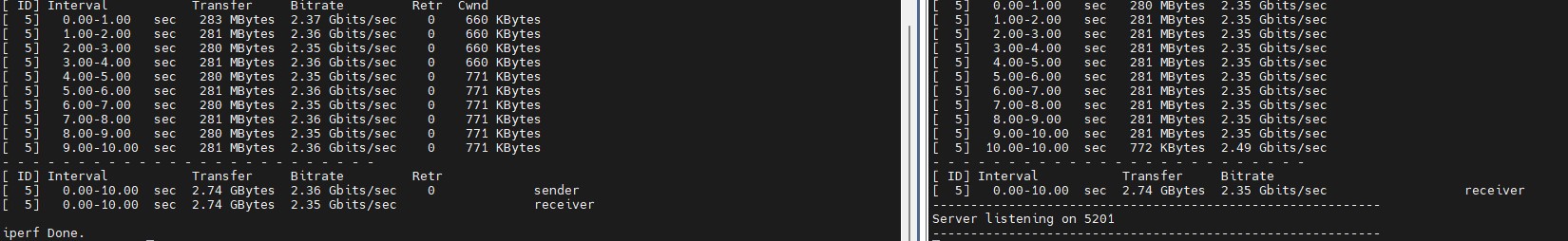

IPERF Tests eines Celeron J5105 sehen vielversprechend aus.
"passing traffic over two dedicated NICs using NAT and 10 firewall rules and zero additional tuning."
"The consistency here just points to that we are running at line rate and we are not CPU limited pushing traffic"
https://www.servethehome.com/two-fanless-intel-celeron-n5105-4x-2-5gbe-options-reviewed/5/
