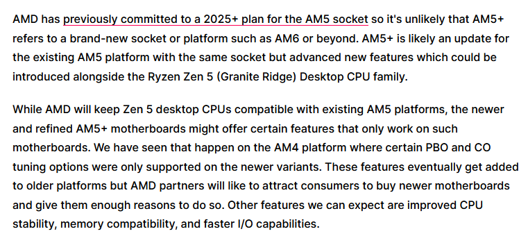

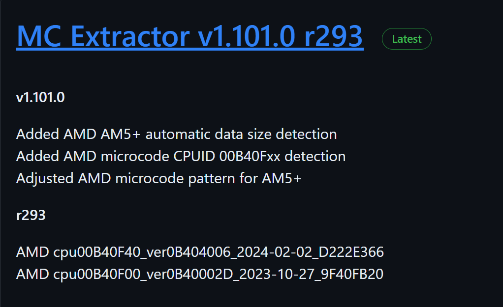

AMD's Zen 5-Based Ryzen "Granite Ridge" CPUs & AM5+ Platform Added In Latest MC Extractor Update​
https://wccftech.com/amd-am5-plus-platform-granite-ridge-ryzen-zen-5-cpus-microcode-extraction-tool/
