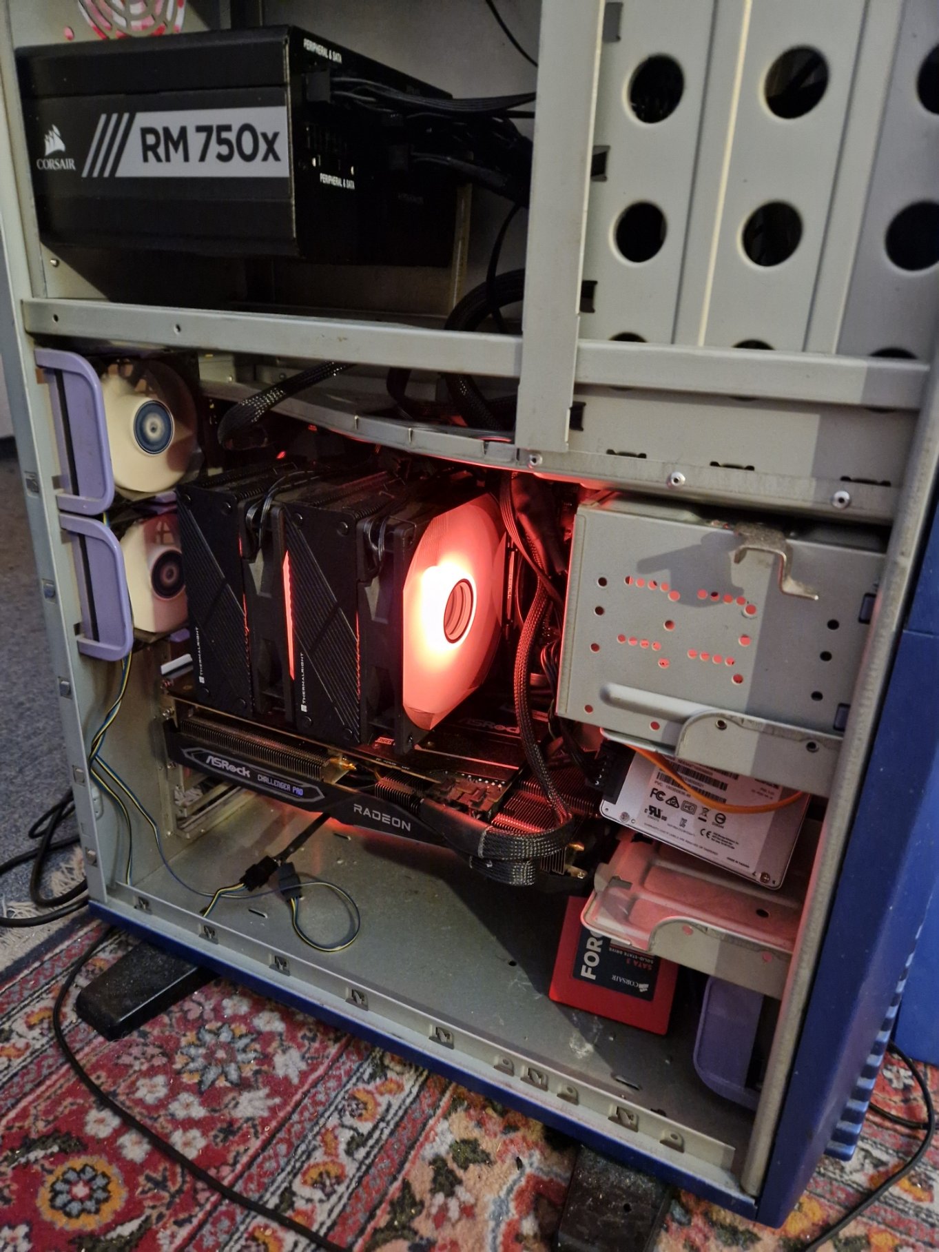

https://www.computerbase.de/forum/attachments/chieftec-belueftung-jpg.1519614/
