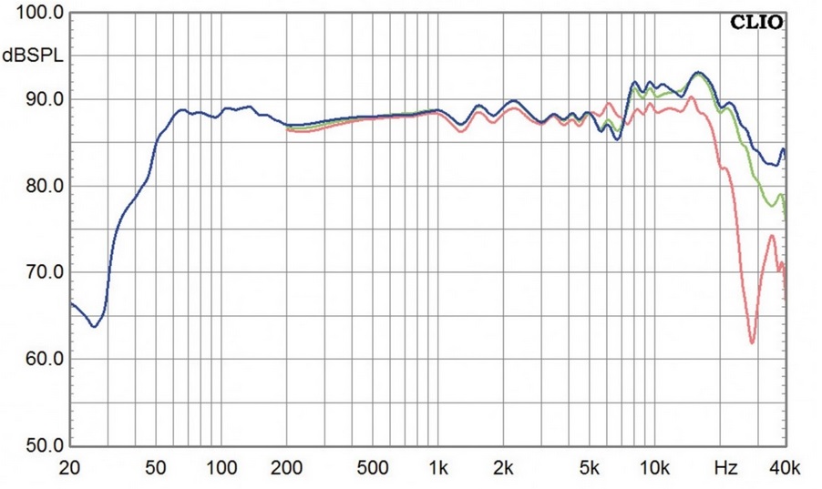

Why? First of all, if the speakers are not full-range, there's no point in trying to make them reproduce low frequencies. Even so-called full-range speakers rarely reach as low as true subwoofers. In your case, the Monitor 11 specifies a low-frequency extension (the frequency that measures -3dB from the nominal level in a typical room) at 30Hz, which is pretty low, but not as low as the PW-2100, which specifies a low-frequency extension of 23Hz.
I was unable to find the CC-390 on the Paradigm website, but the CC-490's low-frequency extension is specified at 43Hz, and the Mini Monitor's low-frequency extension is 42Hz. The specified on-axis frequency response (±2dB) of the Monitor 11 goes down to 42Hz, while the CC-490 goes down to 65Hz and the Mini Monitor goes down to 75Hz.

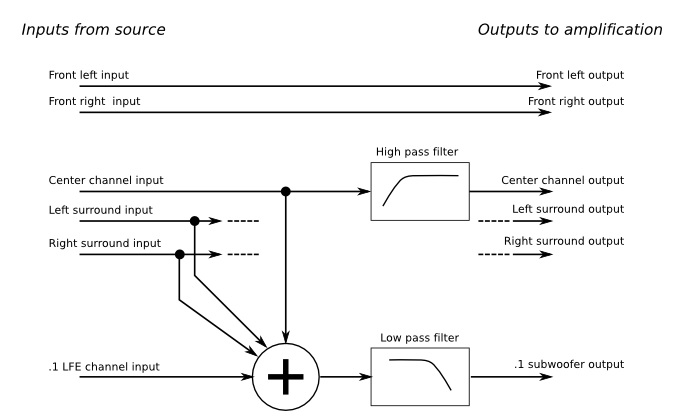

Meine Frage an dich, hast du eine Quelle, wo das BMS rerouting der small speaker (auf die large) erklärt wird, wenn front auf large stehen und sub vorhanden?
Ich denke das geht z.B. so... aber danke schon mal.
