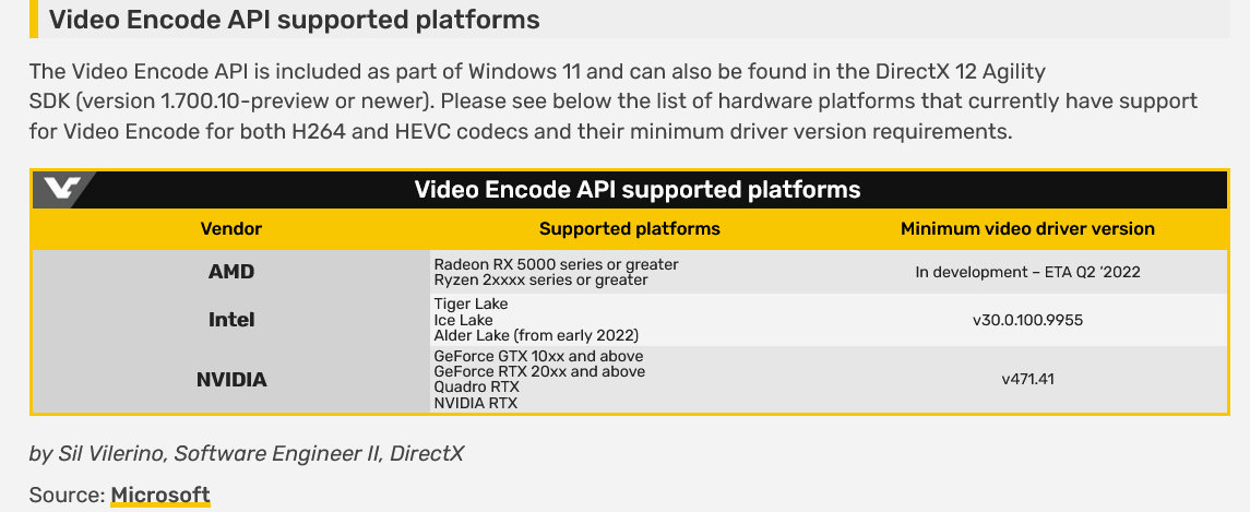

Microsoft DirectX H264/265 Video Encode API now available for Intel and NVIDIA GPUs, AMD in Q2 2022
https://videocardz.com/press-releas...able-for-intel-and-nvidia-gpus-amd-in-q2-2022
Screenshot 2021-12-09 at 11-55-36 Microsoft DirectX H264 265 Video Encode API now available fo...png
https://devblogs.microsoft.com/directx/announcing-new-directx-12-feature-video-encoding/
