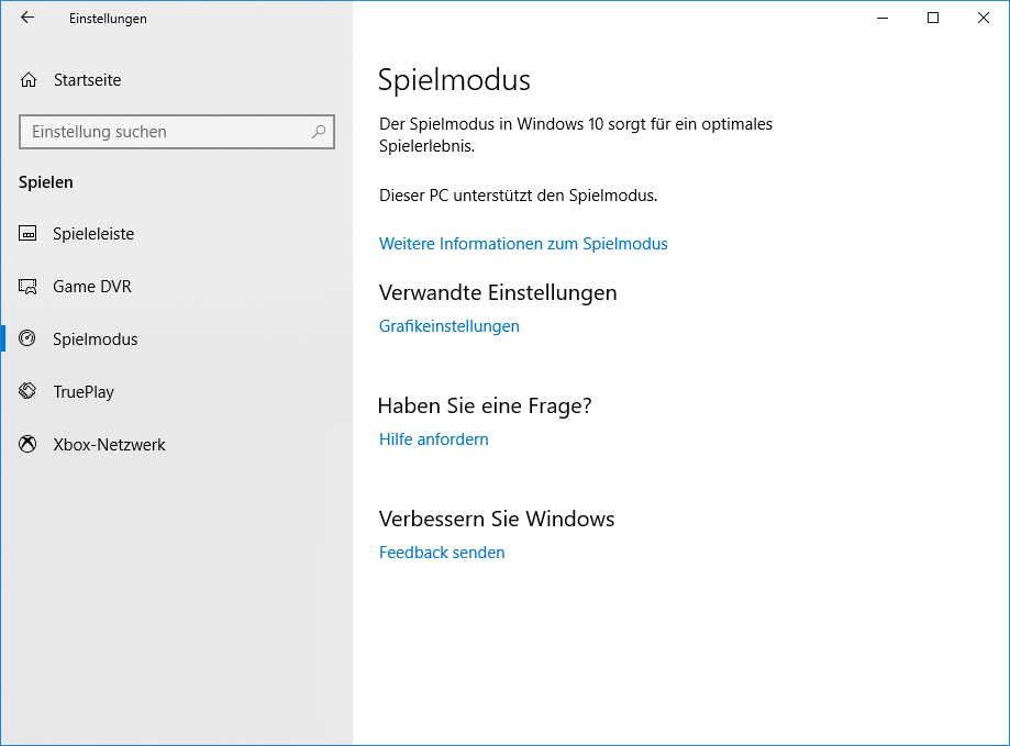

Bei mir gibt es gar kein Regler zum ausschalten?
Ach toll gemacht Microsoft: "There was a little switch to control in the Settings app under Gaming>Game Mode. That little switch is gone in the Fall Creators Update. If your PC supports Game Mode, then it will be on."
