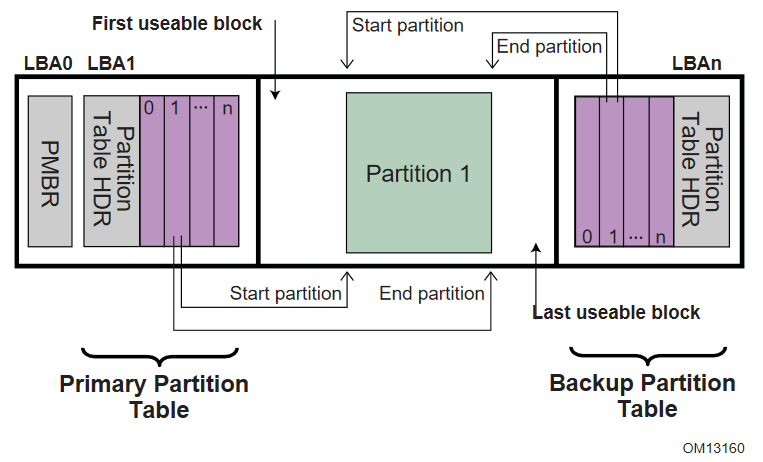

Windows und Partitionen:
UEFI Specification Version 2.8 (Errata B) (released June 2020)
5.3 GUID Partition Table (GPT) Disk Layout
