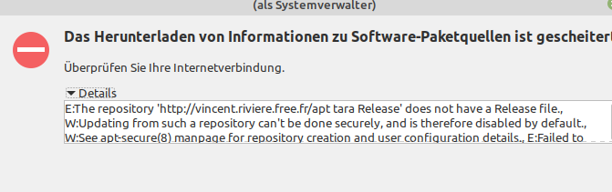

Also, ich habe alle Häkchen entfernt. Dann kam "Das Herunterladen von Informationen zu Software-Paketquellen ist gescheitert" und ich bekomme diese Meldung (leider konnte ich das nur so rauskopieren)
Code:
E:The repository 'http://vincent.riviere.free.fr/apt tara Release' does not have a Release file., W:Updating from such a repository can't be done securely, and is therefore disabled by default., W:See apt-secure(8) manpage for repository creation and user configuration details., W:Target Packages (main/binary-amd64/Packages) is configured multiple times in /etc/apt/sources.list.d/signal-xenial.list:3 and /etc/apt/sources.list.d/signal-xenial.list:4, W:Target Packages (main/binary-all/Packages) is configured multiple times in /etc/apt/sources.list.d/signal-xenial.list:3 and /etc/apt/sources.list.d/signal-xenial.list:4, W:Target Translations (main/i18n/Translation-en) is configured multiple times in /etc/apt/sources.list.d/signal-xenial.list:3 and /etc/apt/sources.list.d/signal-xenial.list:4, W:Target Translations (main/i18n/Translation-de) is configured multiple times in /etc/apt/sources.list.d/signal-xenial.list:3 and /etc/apt/sources.list.d/signal-xenial.list:4, W:Target DEP-11 (main/dep11/Components-amd64.yml) is configured multiple times in /etc/apt/sources.list.d/signal-xenial.list:3 and /etc/apt/sources.list.d/signal-xenial.list:4, W:Target DEP-11 (main/dep11/Components-all.yml) is configured multiple times in /etc/apt/sources.list.d/signal-xenial.list:3 and /etc/apt/sources.list.d/signal-xenial.list:4, W:Target CNF (main/cnf/Commands-amd64) is configured multiple times in /etc/apt/sources.list.d/signal-xenial.list:3 and /etc/apt/sources.list.d/signal-xenial.list:4, W:Target CNF (main/cnf/Commands-all) is configured multiple times in /etc/apt/sources.list.d/signal-xenial.list:3 and /etc/apt/sources.list.d/signal-xenial.list:4, W:Target Packages (main/binary-amd64/Packages) is configured multiple times in /etc/apt/sources.list.d/signal-xenial.list:3 and /etc/apt/sources.list.d/signal-xenial.list:5, W:Target Packages (main/binary-all/Packages) is configured multiple times in /etc/apt/sources.list.d/signal-xenial.list:3 and /etc/apt/sources.list.d/signal-xenial.list:5, W:Target Translations (main/i18n/Translation-en) is configured multiple times in /etc/apt/sources.list.d/signal-xenial.list:3 and /etc/apt/sources.list.d/signal-xenial.list:5, W:Target Translations (main/i18n/Translation-de) is configured multiple times in /etc/apt/sources.list.d/signal-xenial.list:3 and /etc/apt/sources.list.d/signal-xenial.list:5, W:Target DEP-11 (main/dep11/Components-amd64.yml) is configured multiple times in /etc/apt/sources.list.d/signal-xenial.list:3 and /etc/apt/sources.list.d/signal-xenial.list:5, W:Target DEP-11 (main/dep11/Components-all.yml) is configured multiple times in /etc/apt/sources.list.d/signal-xenial.list:3 and /etc/apt/sources.list.d/signal-xenial.list:5, W:Target CNF (main/cnf/Commands-amd64) is configured multiple times in /etc/apt/sources.list.d/signal-xenial.list:3 and /etc/apt/sources.list.d/signal-xenial.list:5, W:Target CNF (main/cnf/Commands-all) is configured multiple times in /etc/apt/sources.list.d/signal-xenial.list:3 and /etc/apt/sources.list.d/signal-xenial.list:5, E:Failed to fetch http://ppa.launchpad.net/wireguard/wireguard/ubuntu/dists/bionic/InRelease  403  Forbidden [IP: 2620:2d:4000:1::3e 80], E:The repository 'http://ppa.launchpad.net/wireguard/wireguard/ubuntu bionic InRelease' is no longer signed., W:Updating from such a repository can't be done securely, and is therefore disabled by default., W:See apt-secure(8) manpage for repository creation and user configuration details., W:GPG error: http://ppa.launchpad.net/gezakovacs/ppa/ubuntu bionic InRelease: The following signatures couldn't be verified because the public key is not available: NO_PUBKEY D45DF2E8FC91AE7E, E:The repository 'http://ppa.launchpad.net/gezakovacs/ppa/ubuntu bionic InRelease' is not signed., W:Updating from such a repository can't be done securely, and is therefore disabled by default., W:See apt-secure(8) manpage for repository creation and user configuration details., W:GPG error: http://ppa.launchpad.net/nilarimogard/webupd8/ubuntu bionic InRelease: The following signatures couldn't be verified because the public key is not available: NO_PUBKEY 531EE72F4C9D234C, E:The repository 'http://ppa.launchpad.net/nilarimogard/webupd8/ubuntu bionic InRelease' is not signed.

Die externen ppas scheinen aber der Fehlermeldung nach immer noch drin zu sein... ich kenne das Mint-Tool jetzt nicht, aber wahrscheinlich reicht es nicht, sie zu deaktivieren, sondern sie müssen wirklich aus der Liste entfernt werden?

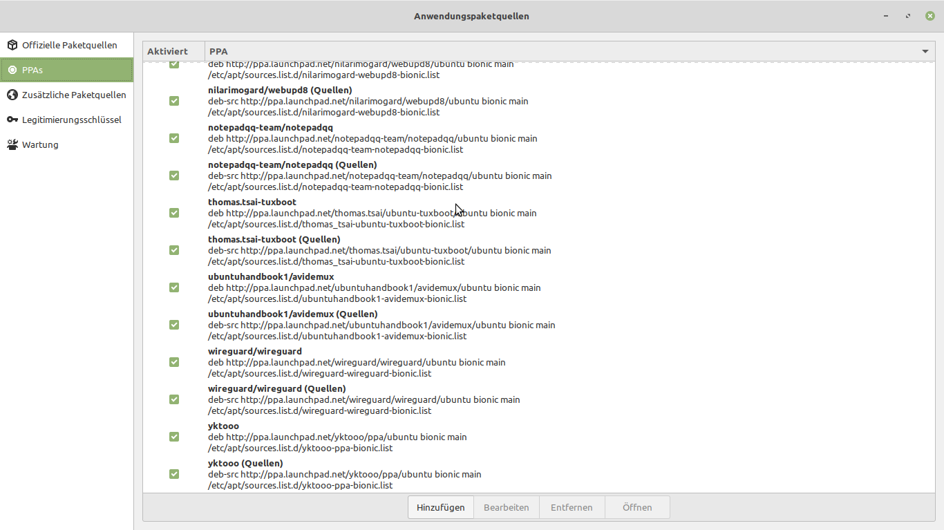

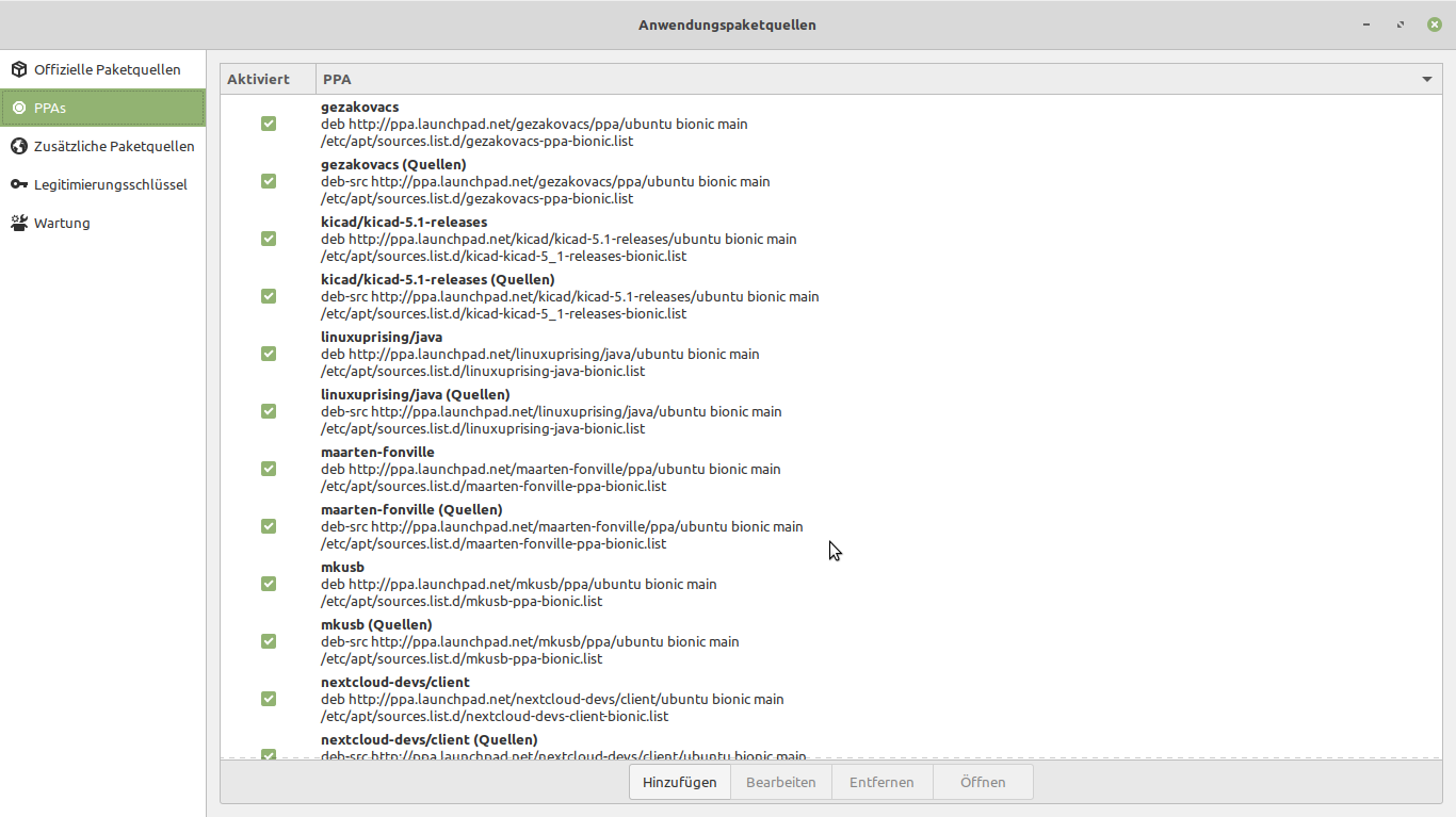

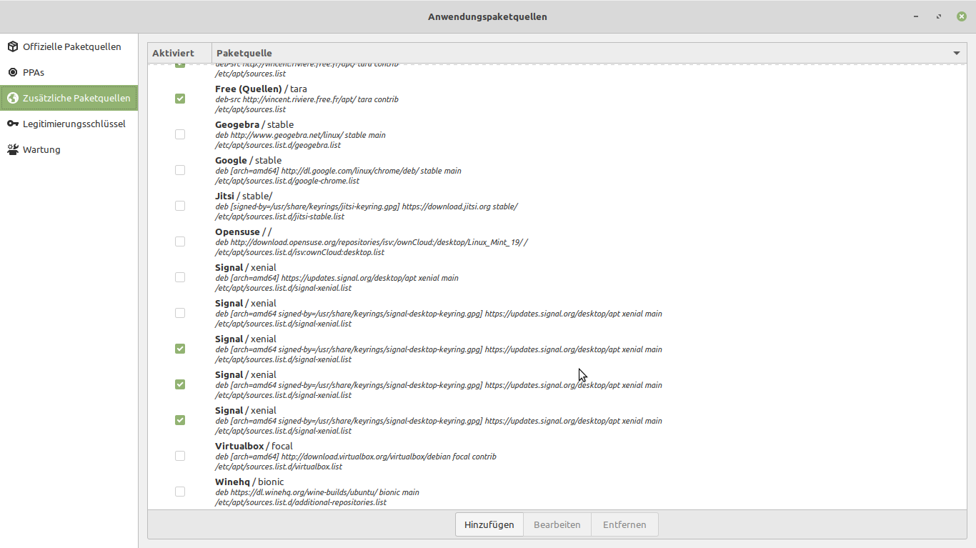

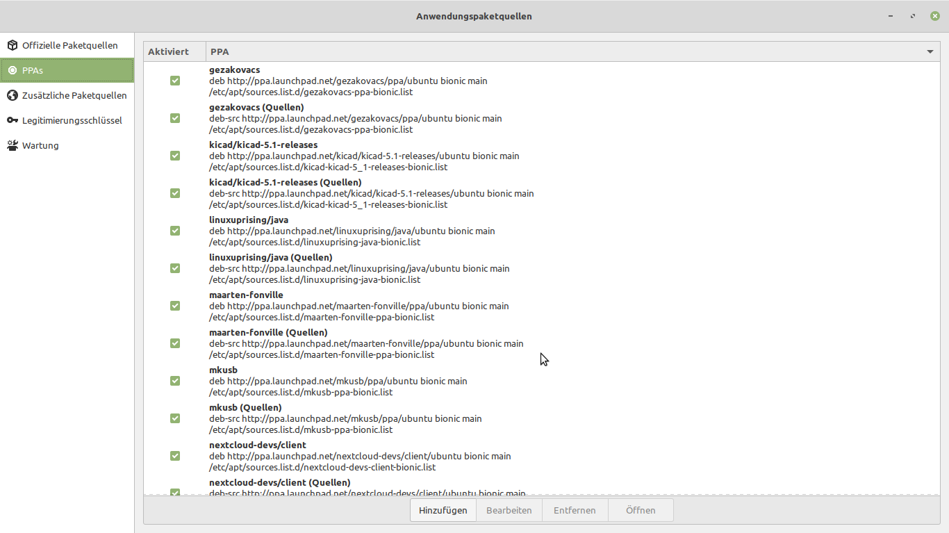

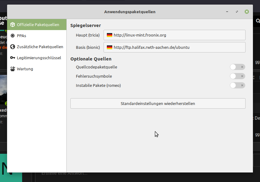

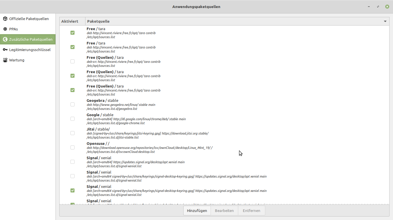

Das Tool ist "Anwedungspaketquellen".

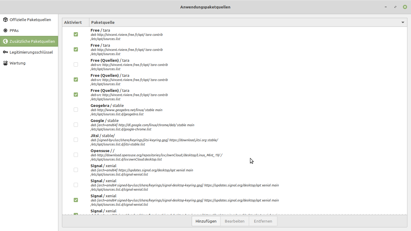

Zuerst sieht es so aus:

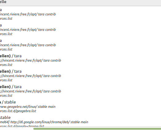

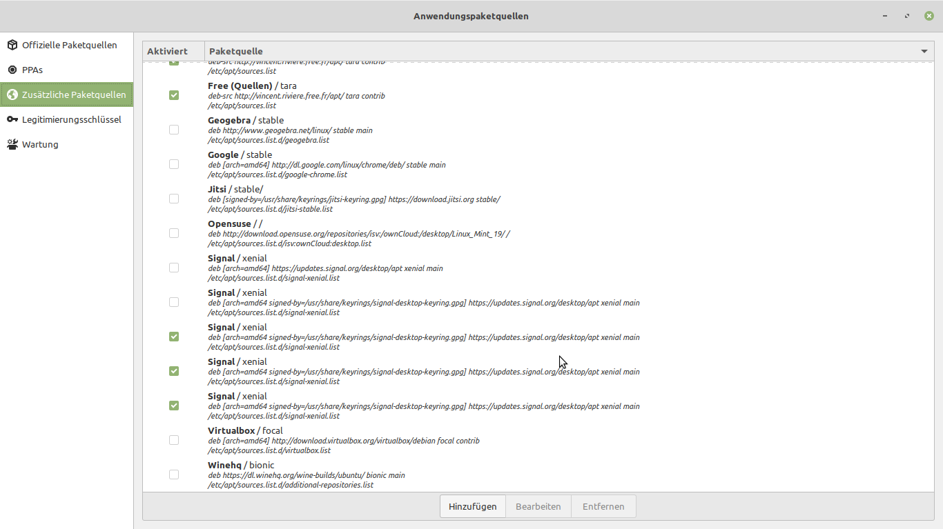

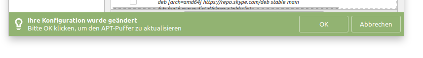

Dann entferne ich die Häkchhen und klicke auf:

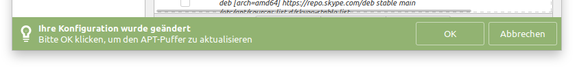

Dann kommt

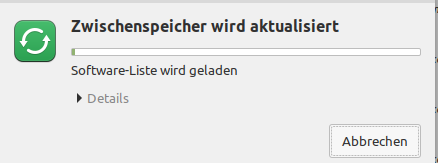

und dann
ALLES RAUS was kein Standard Mint repository ist, weil du das nicht gemacht hast hast du noch den Error (so sieht es für mich aus)
Wenn das update mal fertig ist und durch kannst du wieder was hinzufügen.
Reaktionen: madmax2010

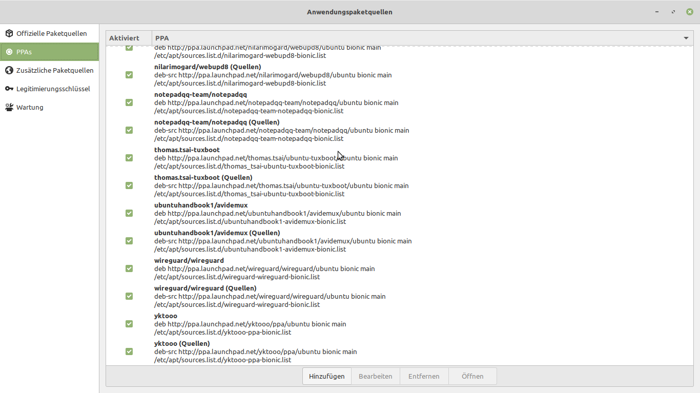

Unten gibts doch einen remove-Button... normalerweise wählst Du ein ppa aus, drückst auf remove und dann kommt wahrscheinlich die Abfrage des root-Passworts, danach ist das ppa aus der Liste raus. Der Haken setzt das Zeug nur auf inaktiv.

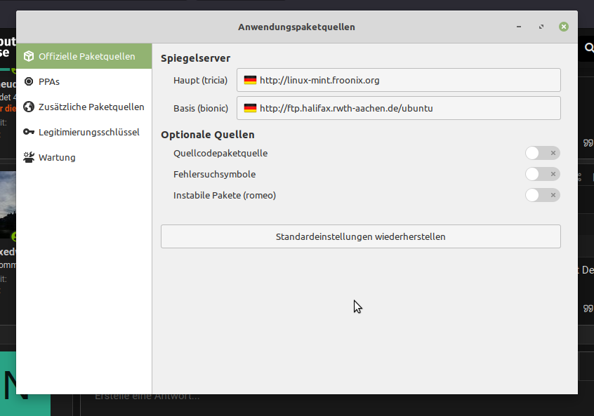

Mach mal einen Screenshot Deiner ppa-Verwaltung.
neudabei schrieb:
Ich verstehe nicht wie das gemeint ist.
Genauso wie ich es vorher auch schon geschrieben habe: Alles was kein Standard-Mint-Repository ist, lässt Deinen Upgrade-Prozess stolpern und muss daher weg.

... und jetzt auch die Fenster "PPAs" und "zusätzliche Paketquellen". Dort steht drin, was bei Dir alles im System drinhängt.
