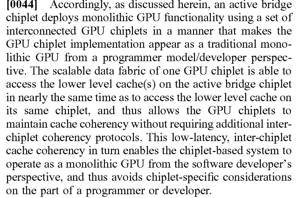

In dieser Patenschrift schreibt AMD , dass sich diese GPU wie eine monolithische GPU verhält:
Quelle:
FABRICATING ACTIVE-BRIDGE-COUPLED GPU CHIPLETS
Various multi-die arrangements and methods of manufacturing the same are disclosed. In some embodiments, a method of manufacture includes a face-to-face process in which a first GPU chiplet and a...
