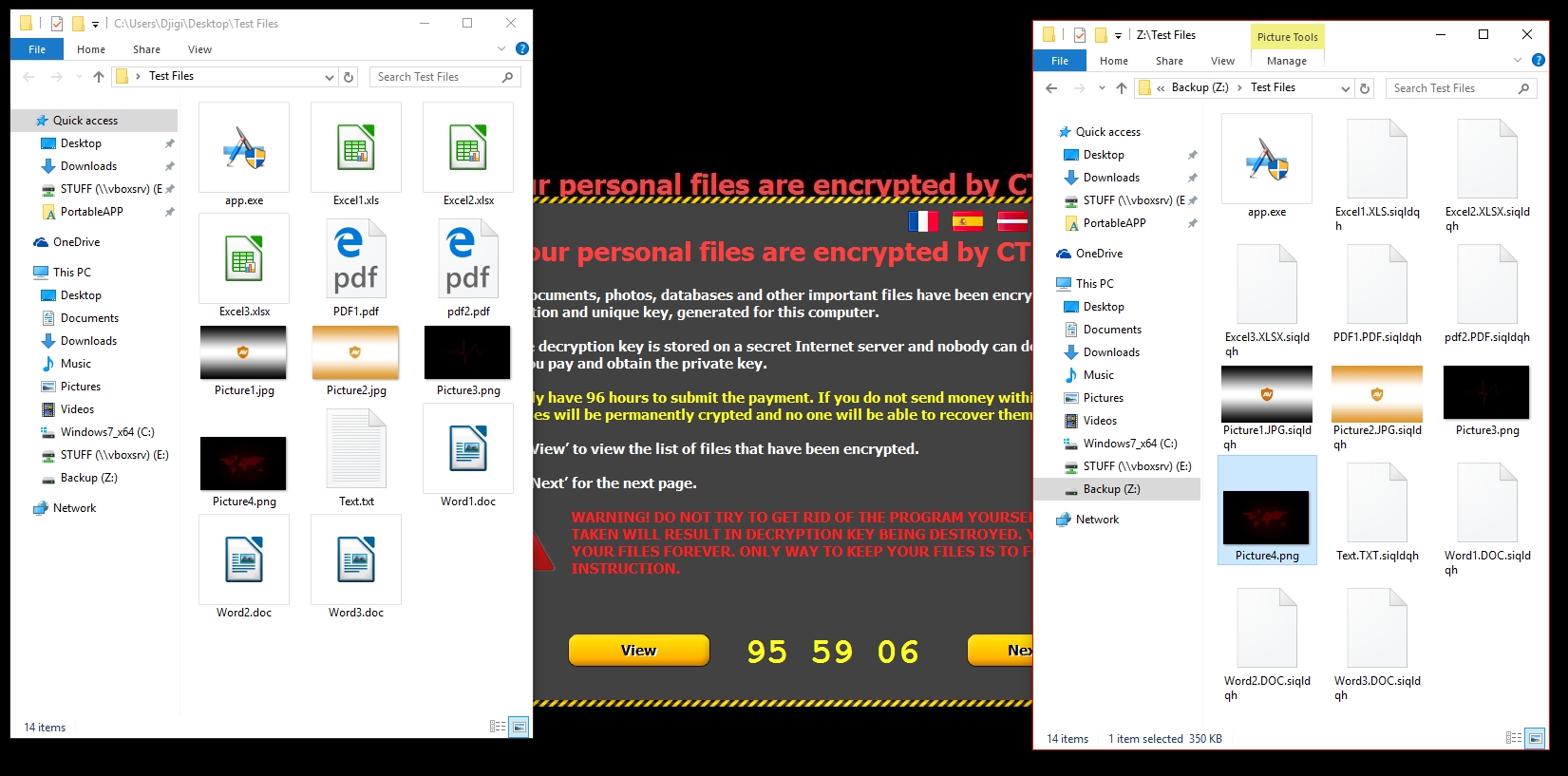

Ich habe es (noch) nicht getestet aber klingt nach einem sehr interessanten Ansatz: https://ransomfree.cybereason.com/
Quasi eine maßgeschneiderte Schutzlösung gegen Kryptolocker
How does RansomFree work?
Cybereason RansomFree watches the way applications interact with files, and when it detects ransomware behavior, it stops it immediately before the files are encrypted. Cybereason RansomFree uses pure behavioral detection techniques and does not rely on malware signatures.
Cybereason RansomFree deploys bait files strategically placed where ransomware often begins it’s encryption. The solution watches the way applications interact with files, and when it detects ransomware behavior, it stops it immediately before the files are encrypted. Cybereason RansomFree uses pure behavioral detection techniques and does not rely on malware signatures.
Maßgeschneidert ist da nix, jedenfalls solange außerhalb von Laufwerk C: munter weiter verschlüsselt wird.
