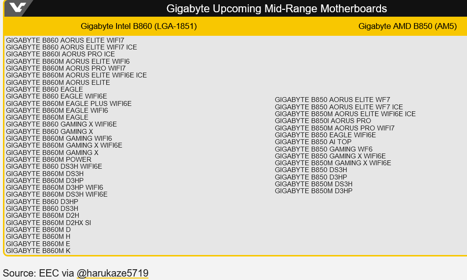

Gigabyte AMD B850 Modelle
Screenshot 2024-09-21 at 10-45-54 Gigabyte preparing over 45 mid-range Intel B860 and AMD B850...png
https://videocardz.com/newz/gigabyt...id-range-intel-b860-and-amd-b850-motherboards
